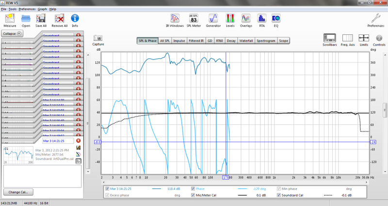

Okay. I followed your directions... I ran back to the store and bought a couple more cables. The one I used for a loop back was a 1/4" male to 1/4" male. I plugged it into the left input and output. headphones to stereo. USB selected. Left gain knob at ~30, Right gain knob is 0, left knob points to computer, right knob points to 3 o'clock.
First graph,
Now check out your measurement in a waterfall graph. It looks like you were able to capture a good measurement. It might help to uncheck some of the boxes on the graph....so you are only looking at one line at time.....at least it makes it easier for me. It looks like you have a pretty big jump around 24hz and a dip around 60hz. Have you tried different sub locations? Also....I'm not an expert at this either....but I have been able to get it to work. Are you happy with your results now?
