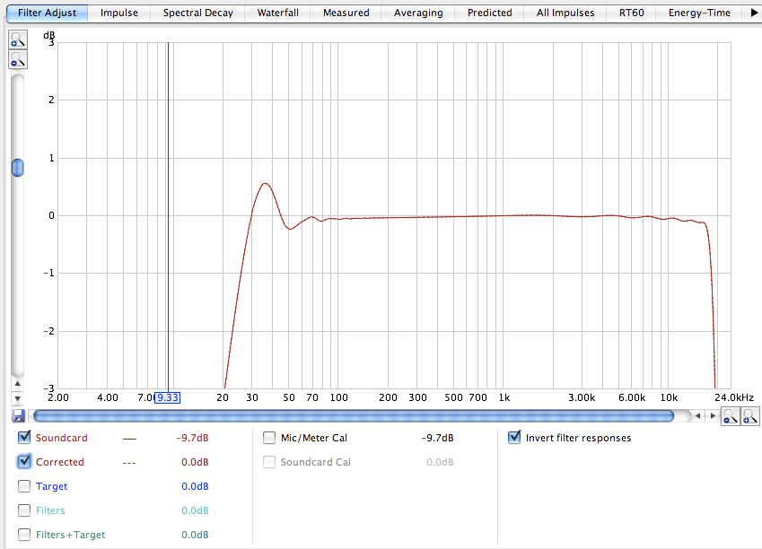

I think the problem may have been my calibration was done at 48k instead of 44.1k with my previous soundcard. When I did my calibration for my new us-122 there was a very noticeable improvement in frequency response when I did it at 44.1, so there may be an issue with 48k on my computer. Either way I did some measurements today and am no longer getting impulse response warnings. I'm also noticing that my measurements are mirroring what I'm getting with my XTZ Room Analyzer system.
John,
Now that I've done a new calibration file how do I make REW stop looking for my old one upon startup and just load the new one?
When you make a new calibration file from a loopback measurement (using the Make Cal... button) REW will automatically load that file next time, but you can also manually browse to the file you want using the Browse... button in the soundcard settings.
I did the 'Make Cal' process five times now with my new Tascam us-122, but every time I open REW it says it can't find the UCA202/Xenyx 802 cal file (which was my previous setup). I always have to manually load the new cal file for my soundcard, the mic cal still loads by itself.
Anyway here's the difference between my calibrations when I do it as 48k vs the much flatter 44.1
The 48k one drops of before 20hz
