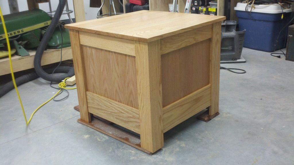

Just a little info on my build.
Currently I am using an older model 200 watt amp to power this so I’ll not be completely satisfied until a more power appropriate amp is purchased. The project was only approved if I could make it appear as an end table in our living/HT/Kids play room in accordance with the wife. It will be down firing and be finished in red oak since it’s locally available to me. I didn’t take as many pictures as I should have and am missing one of the final bracing. I will do more of the finishing and listen impressions once I get a larger amp (recommendations welcome). This is my first attempt at a HT sub.
Outside box dimensions are 20.75x24x24
After driver and bracing and port volume subtracted I have about 4.40 cu.
Ports are 4”x31” with what I’d call semi flared ends.
Double 1.5” front baffle with posted mounted just above the driver.
Driver on the work bench.
Current weak amp being used to test.
One brace and ports installed. A rounded edge circle of MDF was used to create a "flare" at the end of the tube. And alot more bracing was installed. This is were I had my picture failure.
I could not wait to test the driver. Here it is in some sloppy bondo.:whistling:
Veneer...
This is were I'm at now. I'll be trying to finish it up this weekend and post more pics.

I got the first coat of poly on last night and went out to sand and do the second coat tonight but its still tacky. So I'll give it another 24 hours. My main worry right now is getting it from the wood shop to the house, Im pushing 150lbs with this thing and Im not as young as I used to be. :flex:
Looks amazing. I may have to use that idea for two 8's and have matching end tables. I dont stray from MDF much though...
Don't be fooled, there is a whole sheet of MDF under there :gulp: LOL.

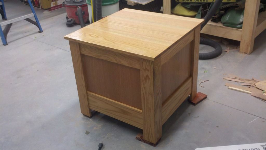

I finished with the final coat of poly last night and it should be ready to be moved into its new home tomorrow morning. I need to wet sand tonight and wax.
Wow, great job, this is a great idea! I bet the WAF on this subwoofer is higher than most :bigsmile:
The wife got to see it in the shop last night. The last time she see saw it I was still working on in and it was in MDF with bondo all over it, she was very worried! The "WOW" remark I got from her last night puts me in the clear I think. :sweat:
Beautiful job. There's simply no other way to put it...

With some help I got the table into its new (hopefully permanent) home. With only my old 200w junk amp I am more than impressed. We watched a few min of X-Men first class before the kids went to bed and in the words of my daughter "holy mollie!" :gulp: It fills the room perfect and you have no idea where the sound is coming from. It is in a corner just to the right of my TV. I'll have to get some pics later but just wanted to update. Can't wait to get my Bash 500.
