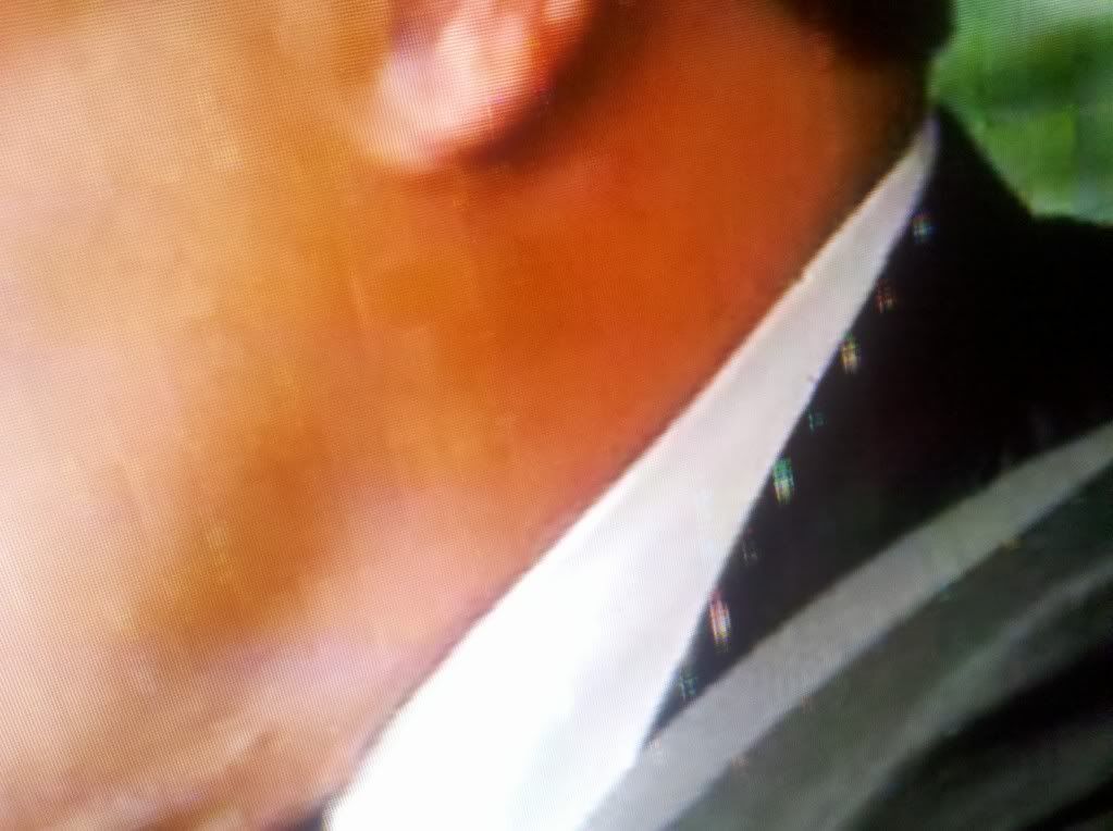

SANYO DP50749 artifact issue. most parts inside are made by LG. I will take a video or photos and post on here. but its almost like things are bleeding over to the right hand side of things. like when i have no input hooked up it says no input found and it flashes around the screen and you can see a trail off to the right hand side of it. also when you watching a movie you see them off the right hand side of things. I already looked over the power boards and all caps and solder joints look good. I am wondering if its the logic board or what. i also hear a sound coming from the ysus. like a high voltage sound but not sure if thats normal for that part or not. its not that notisable unless your or lissening for it.

I don't know anything about ajusting that. I dont have a scope. Tv is a 2009 model and was a customer store return. None of the boards even show any burn in hot spots. Do you know what board would control this issue? I see lots of boards for this model on ebay. It's not just whites that bleed over its all colors. It seams like it gets lines of colors off to the right hand side of things.

I just looked at it again. its only lighter colors that bleed over to the right. and they are lines that go up and down.
