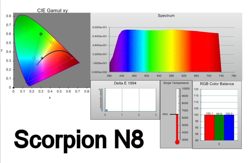

Scorpion N8 is a 50:50 mix of Cream & Sugar : Black Widow
4 parts Bermuda Beige - matte or flat enamel preferably Valspar Ultra Premium Flat Enamel (we call it VUPE)
1 part Auto Air Aluminum Fine (can be acquired online at Dick Blicks or someplace locally that sells specialty auto paints)
Mix the above equally with this:
2 parts Sherwin-Williams Luminous White flat interior latex
1 part Craft Smart Metallic Silver (can be acquired at Michaels)

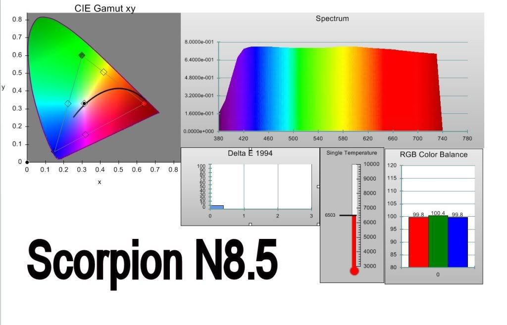

Scorpion N8.5 is this:
8oz of Bermuda Beige - preferably Valspar Ultra Premium Flat Enamel - I've also tested Pittsburgh Paint Grand Distinction Flat Enamel (they may call it matte - I'm too lazy to run and check the can)
2oz of AAA-F
40oz of Luminous White matte - I have yet to check High Reflective white totally but I have no reason to doubt it would work at the moment.
8oz of Craft Smart Metallic Silver
Scorpion N8 spectrophotometer readings
Scorpion N8.5 spectrophotometer readings
We've had several beta testers try it out and they all liked it but we never got any photos to go along with this. I plan on doing full photo tests of these in the very near future. I also have some reflective readings from my projector on one of these two on my laptop that I'll post tomorrow. :T
