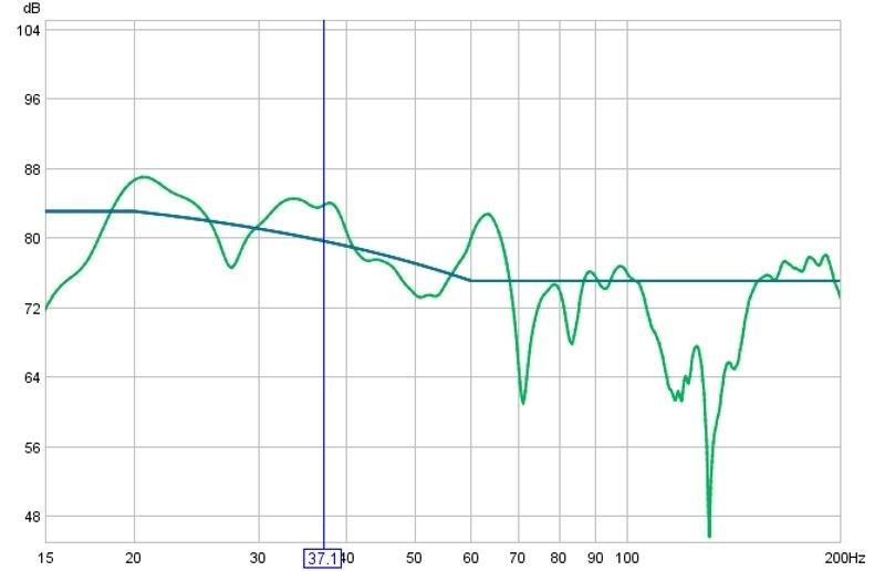

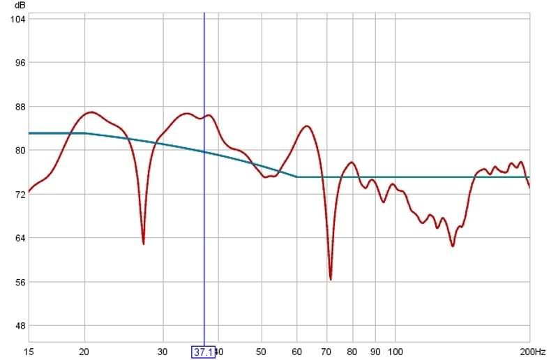

Here's what everything looks like:
(I also have graphs of each main separately with both 60 and 80hz xo's but I didn't post)
Sub baseline with receiver xo for sub set at 60
Sub baseline with receiver xo for sub set to 80

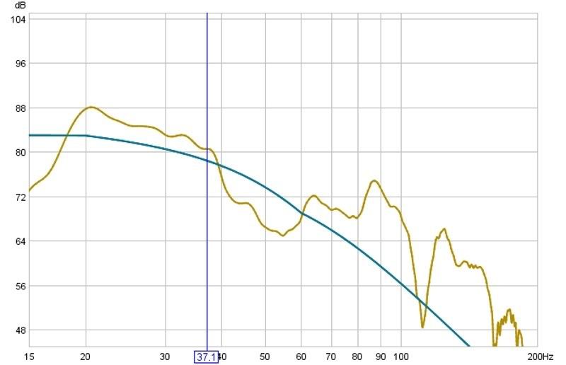

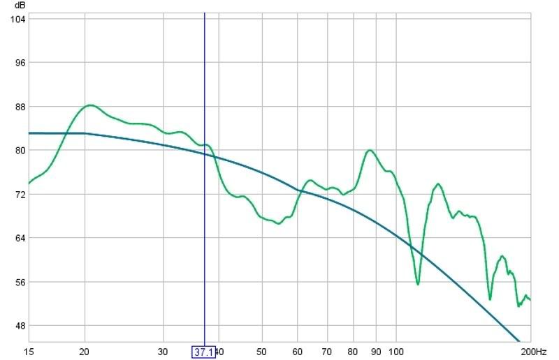

both mains with receiver xo for mains set to 60
both mains with receiver xo for mains set to 80

7,514 Posts
Overall it doesn't look too bad.
Integrating a standalone sub with a set of towers using integrated subs is quite tough.
You can see the cancellation that's occuring when you try and mix them together, so playing with the phasing (or placement) of the standalone sub will be needed.
The integrated subs appear to be doing a good job, except they don't extend down as low as your standalone.
I wonder if using the standalone for only very low frequencies might be a better idea. Setting its crossover to something like 30 or 40Hz might reduce some of the cancellations you're experiencing..

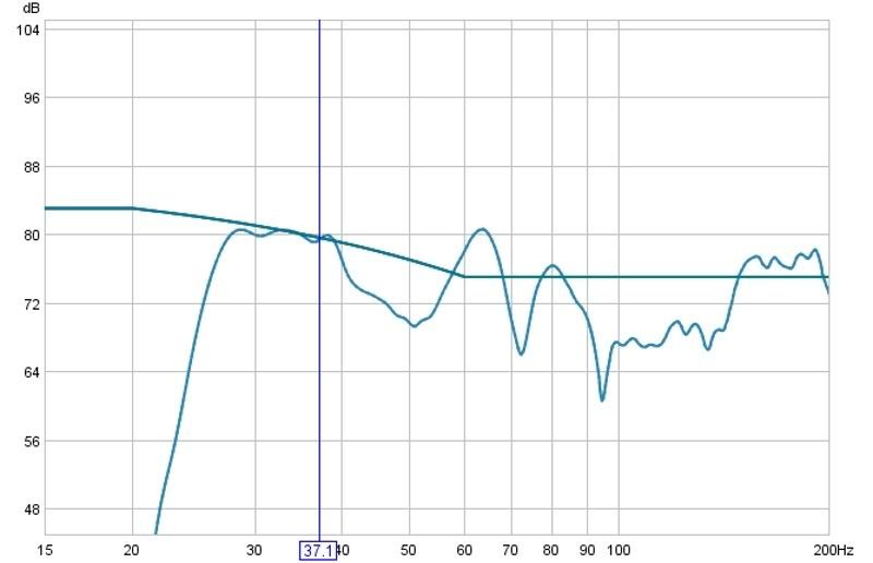

here's both the sub and mains xo @ 40

Am I right in choosing the 40 hz xo setting?
It then looks like REW will setup some filter to deal with 30-40 hz peak.
Is there anything I should/can do about the peaks at 62 and 78 hz?
It appears about the best. BTW, it's a lot easier to compare graphs if you use the Measured tab for overlaying them rather than on seperate plots....
A BFD could remove all those peaks...
