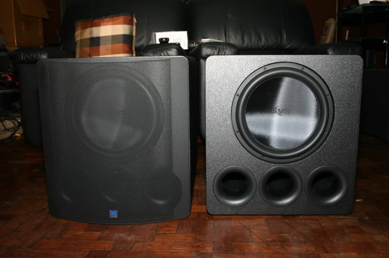

Once out of the box (had to turn the box on its side to do so) I took off the plastic wrap and hulled out my old A/D/S MS3u sub and placed it beside the Ultra, You can really see the size difference in this photo.
The fit and finish of the PB13 Ultra is really something to talk about. It looks amazing just sitting there and will most defiantly be a conversation piece in any room.

Tony, just curious what you plugged the port with.
each SVS Ultra includes three foam port bungs to retune the subwoofer to:
20hz = no bungs
15hz = 1 bung
10hz = 2 bungs
sealed = 3 bungs
Good to know that SVS is looking after things! I just noticed in the above pic of the sub that a bung is placed in the center port.
