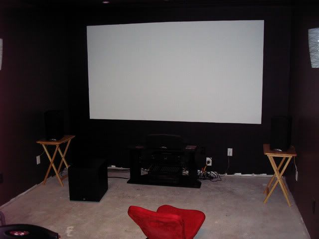

I am still at it. I made the mistake of setting up the equipment before the room was completed. We have been watching movies for 2 months on primered drywall. The picture is very good but, I can't wait to use the DIY screen kit. Hopefully, beginning in April, I will make the final push to completion.
