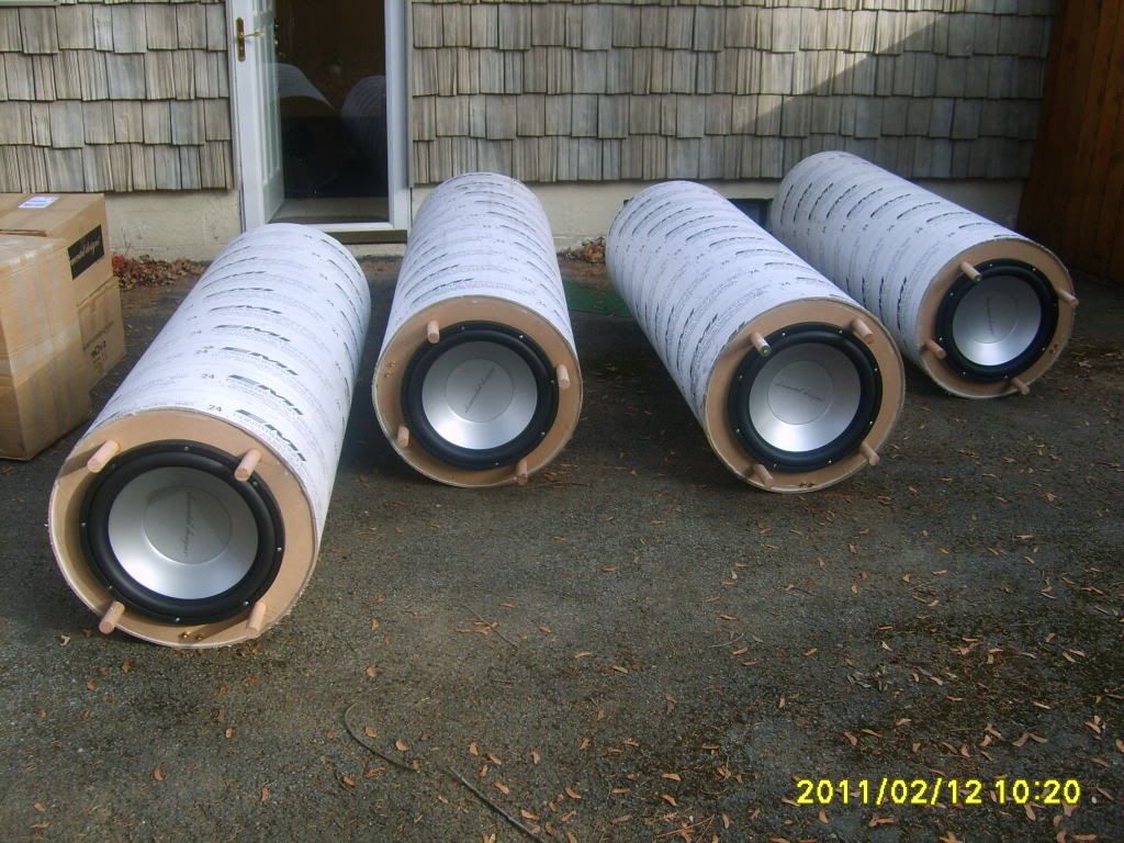

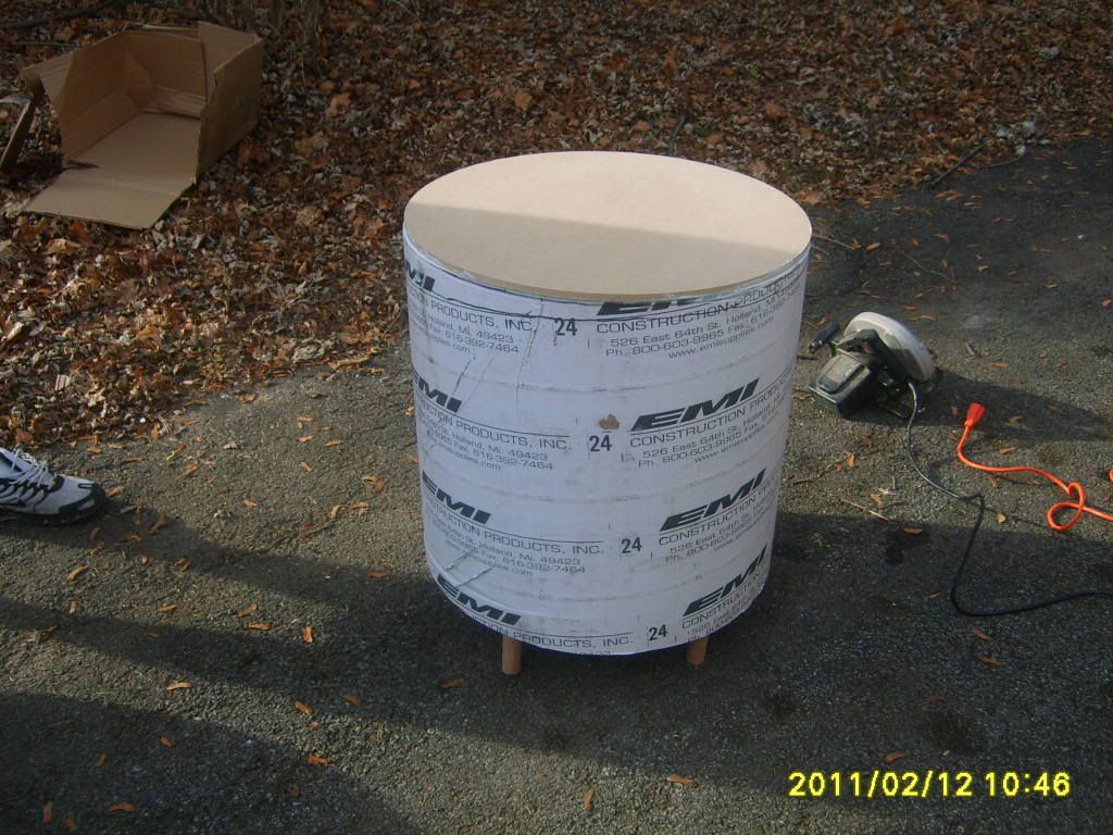

I have not posted in a long time and wanted to share some of my experiences with you. I try many different pieces of equipment in my theater just for curiosity and trying to get that extra something. Sometimes I succeed and other times I just waste money. I have owned many subs and other pieces of equipment and as I changed things out I have figured some things out. My favorite commercial subs that I have had experience with are Klipsch THX ultra 2 subs with amps and dual SVS 16-46cs+ subs with Samson amps. The bass was great with these subs and the performance was similar in my room. I then tried some pro subs that did not have as flat as a curve but the power from 20-80hz(my crossover) was amazing. I used to hit 115 db's with the other 2 subs from 16-80hz at my listening position and I would hit 110 db's at 15 hz with the pro subs and 125 db's from 20-80hz. Once I felt the 125 db's it was all over for me. So I called SVS wanting to know what would it take to reach these levels with the 16-46cs+ and the cost was too great. My goal was to reach 125 db's from 15-80hz. Ed at SVS pointed me toward DIY and sonosubs for a cheap solution. I ended up building four 6 feet tall and 24 inches round sonosubs using the elemental designs 190v.2 drivers which is 18 inches. I tuned them to 13.4 hz and in my room(a 2300 cubic foot room with great room gain) would extend down to 10 hz and I reached my goal. I called those my silo missles. I kept reading and hearing how great sealed subs sound and how in a sealed room could naturally extend down to 5 hz with good gain which I knew I had(after owning the pro subs). So I cut my sono's in half and ordered 4 more eD 18 inch drivers. I built 8 sealed 24 inch tall and 24 inch round(same sono) subs and I am using 4 behringer ep-2500 amps running in stereo with a 2 ohm load. I do like the sound overall and the bass seems not as powerful but then I took out the spl meter and I was over 126 db's no matter what scene I played. I am very happy and do get flat extension down to 5 hz. Here are some pics of the black canons which I have 2 in every corner.
It started with these, the silo missles.
So I turned them into these:

Each sealed enclosure is 5.5 cubic feet wired in 2 ohms with one channel of an EP-2500.
