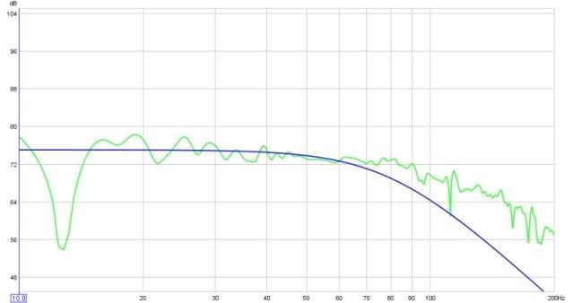

I use the UCA202, and it works great. There is a volume control switch on it that has to be turned off otherwise you will get low volume warnings (even if the volume is turned all the way up).
Here is an example graph (no smoothing) of my dual SVS PB13 Ultras (using UCA202 and digital RS SPL meter)...
