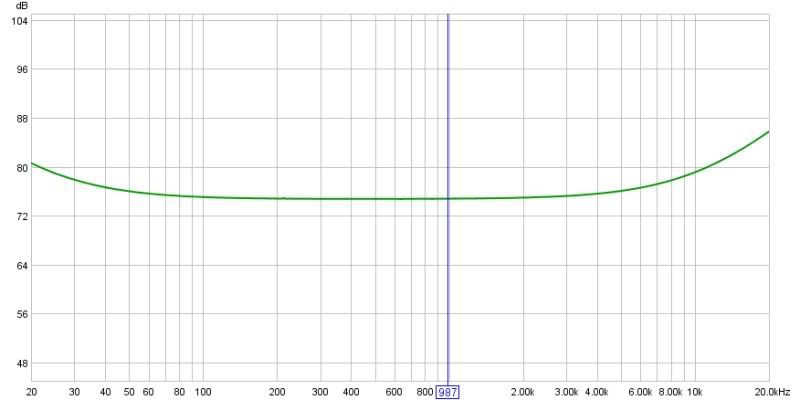

I'm trying to perform some output tests on my processor regarding x-over points and slopes. To remove all other components from the readings (amp, speakers, etc), I have the line output of my processor connected directly to the input of my soundcard.
Here is the result:
I turned off the RS analog meter calibration file, so why the smiley face graph?
Thanks.
41 Posts
Uncheck the C-Weight box...............
I knew that! I guess I was just in too much of a hurry. I got away from using REW for a few months. It's so easy to forget the little things.
