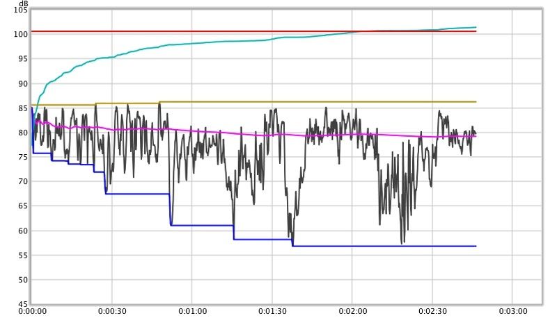

I have REW running on my Mac (OSX Yosemite). I have a umik1. For whatever reason LZpeak never goes above 100.6db. I'll hit it at -25db or 0db (with my ears plugged). Should I be using LAFmax? Even if I crank up the volume to 0db I still don't hit > 100.6db for LAFmax which I would expect adding 20db to the graph below. Is there a limit here in REW or the UMIK?

The maximum input level the UMIK can measure depends on the input volume setting. If the UMIK is from the last couple of years, the maximum input with the input volume set to 1.0 is about 100 dB, above that the mic will clip. When input volume is 1.0 the mic actually applies 24 dB of internal gain, if the input volume is lowered to the point it applies 0 dB of gain the maximum input level would be about 124 dB. The 0 dB setting on a Windows 8.1 machine is 0.52 or 52%, but you can see the setting more easily by setting the input volume control to show dB instead of percent by right clicking on the volume control on the Levels tab of the input properties.

The safe levels depend on how long the exposure lasts, a level that can be tolerated without harm for a short time could cause permanent damage if it continued for a longer time. The 'equivalent sound level' takes account of the varying levels of sound over the measurement period to provide a number that takes account of the overall 'dose' of sound, so typically LAeq would be the figure to monitor. Over an 8 hour period the maximum Leq figure for the UK is 85 dBA, for example. This paper from Bruel and Kjaer explains the various terms and their relevance.
