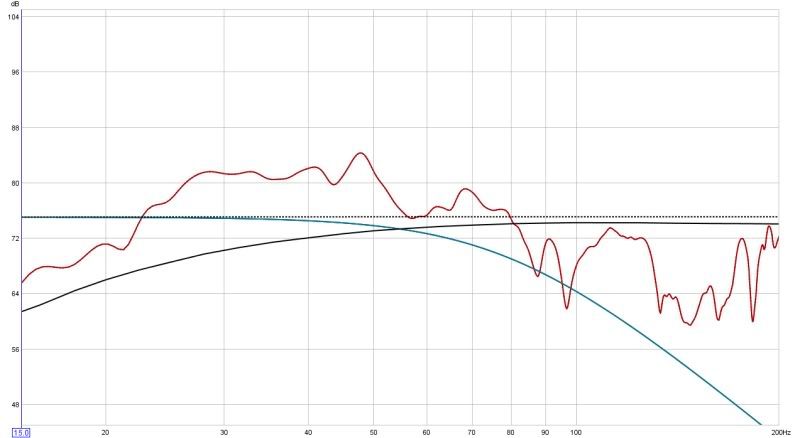

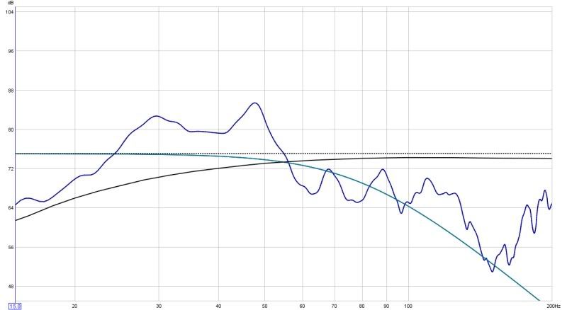

Hey guys here are some pics of my REW sweep with my pa-120 sub. Would adding a BFD to the picture be beneficial to me or should I not worry about it?
corner loaded
left side of the entertainment center

Response at the entertainment center is pretty good. A BFD would help you get a house curve, if you're interested in that, and perhaps get a smidge more extension, assuming you have the headroom.
It is a bit curious that a sub rated for extension to 24 Hz can't manage to go that low, and that the corner reading has less extension than the other one. Is your room overly large, or open to other areas in the house? Are there openings in either of the walls near that corner?

Well it's pretty much a big open room connected with the kitchen/dining room, vaulted ceilings, and then the front room which is divided by an 8' high wall between the kitchen and front room. There is also a hallway at the back left corner of my room. The room is about 14' front to back and about 50+ wide, counting all rooms.
The corner that the sub is in is pretty much the only solid corner in the room (front right).
Here's a quick sketch.

Wayne I went ahead and messed around with things today, but I'm having a few issues with REW. I backed the gain down on the sub from 6 to 5 and I re-ran audyssey with the sub on the left side of my entertainment center. My AVR now set the level to 0db when it was at -4db on my last sweeps. I level checked everything with my SPL and I bumped the sub to +2db just to run it a little hot. Now on my very first attempt at calibrating my soundcard a couple days ago it showed this...
I went back to do everything over in REW and now I can't get anything different from this!
I messed around with it for a couple hours. :explode: I don't know why it is so different now? Could it be that I did not get it correct the first time I calibrated it or am I doing something wrong now? When I went back and loaded the initial soundcard file, on measure/level check it kept telling me I was clipping and I had to back the level down to lower than a 75db reading on my spl.
Now I went ahead and ran some sweeps with that second sound card file. I had headroom available and I came up with these results. These look better than what I was getting, but I don't want to get my hopes up because of the soundcard issue.
:help: Help please.

Wayne, if it says I'm clipping in REW and I have to back it the level down then wouldn't I be running the sweeps below the 75db ref point? And would that affect the sweep and results? Could my lack of low extension be attributed to the large open floorplan design?
· Super Moderator
9,359 Posts
It will have no effect on the results, other than showing the overall level a bit lower than it otherwise would have been.
Possibly, but most likely no more than a few Hz. The biggest detriment to large open floor plans is reduced headroom. However, they make up for it in other ways, like more uniform response across a broader seating area.
