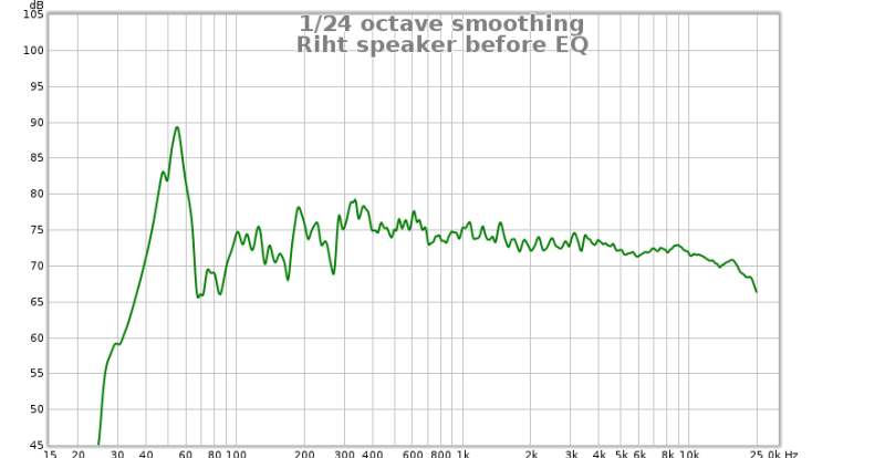

First, here are the measurements before equalisation. These are the average of 6 measurement for each speakers, separated by about 40 cm from each other, so as to match a wide range of possible listening positions.

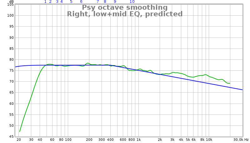

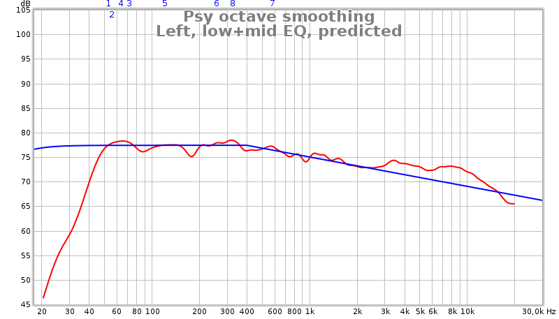

I then carefully equalized them, checking in the overlay view of REW the 6 separate measurements to ensure that the corrections I was doing were valid for a wide enough set of listening positions.
The corrections are small, but I think that the problem in the low-mid is now reduced. The current result sound incredibly well balanced. Here are the predicted psychoacoustic curves :

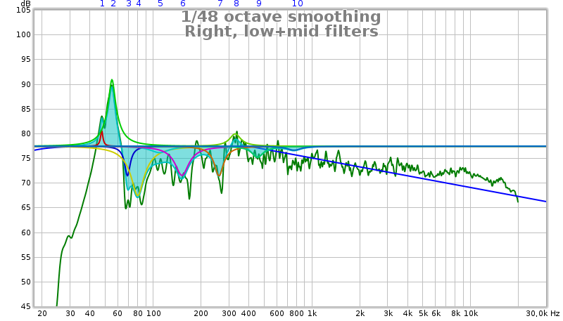

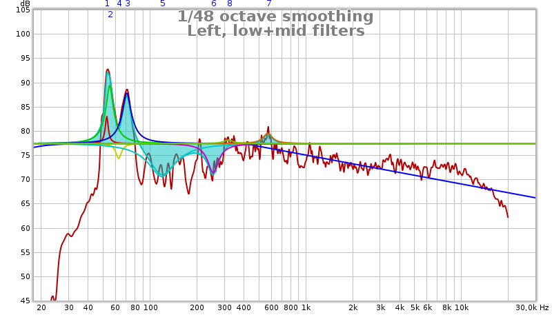

And the filters used :
