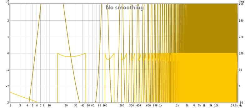

Hi all,
Having used rew before Ive setup a new computer with REW through a creative sound blaster sb0460 'extreme music' sound card. Im trying to calibrate the card at the moment- with no luck.
Ive seen the help files comments on some sound blaster cards and have turned monitoring off already.
The help files say-
on some other Creative soundcards (e.g. Audigy 2 ZS) there is a Record Advanced Controls setting for "Record without monitoring" that must be selected. It can also happen if "Line In" is not muted in the Playback mixer for the soundcard.
cant see this option for my card so I assume it doesnt apply. Line in isnt listed on the 'volume mixer'.
It was a very popular card a couple of years back, so im sure someones worked this one out?:dontknow:

Hi earl, thanks for the info.
I have the latest firmware (same as you linked) and have tried every option I can think of on the sound card control card but still no luck as yet.
More fiddling tonight, but my hope is fading.
*edit* sorted!!
for some reason it all works fine if I use ASIO output and select to output signal from the right but connect to the left!!!!????? god knows what thats all about.- I suppose the Chinese 3.5 jack to rca splitter cables could have been incorrectly labelled maybe.
god, that took me 3 sound cards and 15 hours to figure.:doh:
